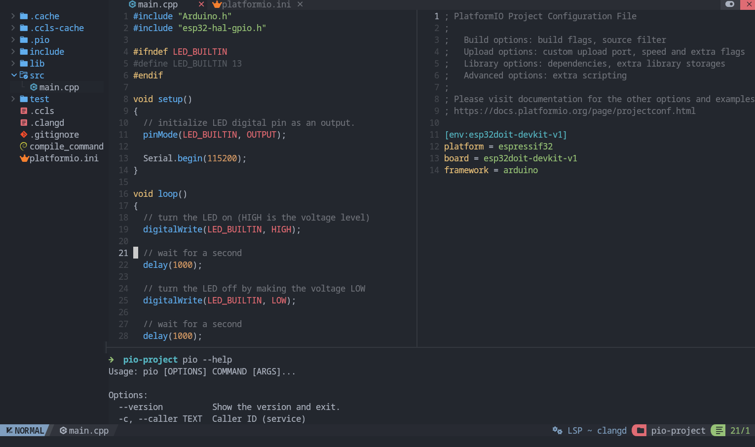

Neovim
Neovim is a powerful, open-source and configurable text editor based on Vim. Neovim is designed for use both from a command-line interface and as a standalone application in a graphical user interface.
../../_images/ide-platformio-neovim.png
